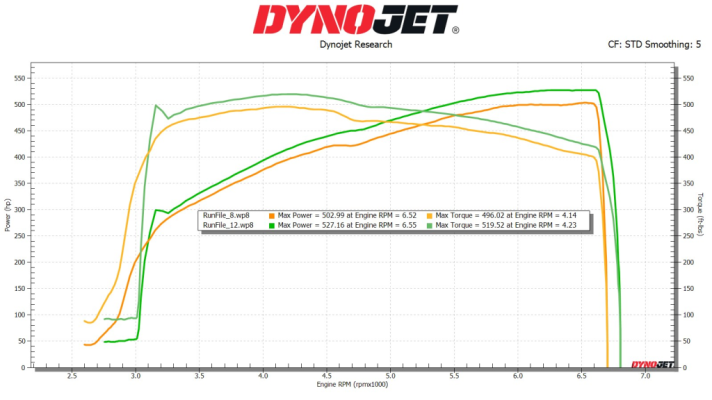

Modern Muscle Xtreme
34m ·
Our MMX Max Effort V2.0 Camshaft is laying down some great numbers this morning. Our 6.4L HEMI V2.0 Cam is a great way to maintain great low speed torque production, all while making some really great horsepower numbers naturally aspirated!
