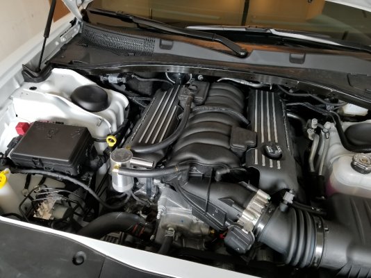

OK, now I am really confused, what the heck is that "stuff" and where is the catch-can placed; in-line with the intake snorkel? What the heck is there to "catch" from the intake snorkel?
To me, a catch-can is a radiator overflow catcher on my Cobra; a requirement for when I have tracked the car...
I forget where they mount on the Ram 1500. My 6.4 Charger has a Billet Tech CC and theirs mounts to a little screw hole on the block that was unused from the factory.
The catch can is basically condensing the crankcase vapors into an oily liquid and preventing this from being sent back up the intake manifold. Plenty of people running Hemis without them and doing fine but some of us would rather spend a few bucks for the peace of mind. Over time it can build up and that hurts power and efficiency. Some intake manifolds have still looked really good after a lot of miles when a catch can has been used. I have collected about a full can worth on my Charger over 5,000 miles.
