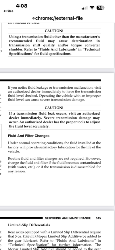

I ask my service advisor and he notes it every time I go in for oil change or service.
Transmission fluid is lifetime .
2020 Lonestar crewcab Rambox hemi
171,000 miles
I have the Maxcare 7 yr warranty, unlimited miles
Jan 17, 2016
23,902
55,071
14 Sport
171,000 miles
What the manual fails to mention is Chryslers version of lifetime is 75,000 miles,just enough to be past warrenty
