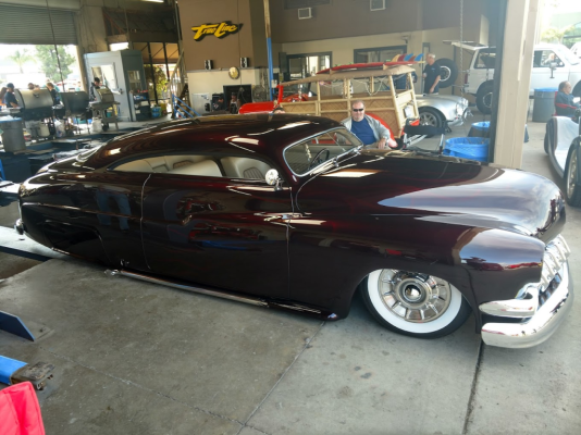

I have used the same shop for my Brakes & Alignment since back in the 1970s
If it has wheels on it, they work on it
Even the rear wheels on my H-D Trike
TRUE LINE WHEEL ALIGNMENT INC.​
This shop has been in business for 50 something years
They are a full service shop
I had my 2009 Dodge Ram there for service
I am hoping that they will allow my to bring my own factory approved Motor Oil
All the local Hot Rodders go there
