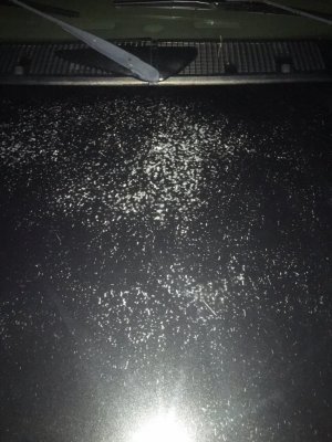

Last weekend I was putting on new windshield wipers and noticed my hood and roof have these white spots. Its weird because it wasn't there two weeks ago!
I am assuming its clear coat? I tried to wipe it off and its not coming off. Its also not flaking which I find weird. Is there anything I can do to stop this or remove it?
Please give me good news lol

Yes it looks like clear coat failure. The only option to fix it is a respray unfortunately. Definitely do not wetsand it.

Given that your truck is a 2008 and looks to be flat black, I'd bet it's single stage paint which is prone to oxidizing rapidly if there's no protection on it at all times. If this is the case, polishing could remove the oxidation and hopefully restore the finish. It couldn't hurt to try since you'd need a repaint if it's just clear coat failure.

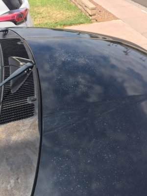

No, if that were the case there would be massive, massive paint failures everywhere. It's either oxidation on single stage page or an old, poor paint job that's finally running it's course and failing.

If your wanting a inexpensive fix if your trying to sell/trade without painting you could always have the roof and hood vinyl wrapped but if it’s a person your gonna sell it today I would disclose the clear failure... dealership well I wouldn’t bother they’ll find a way to screw you on pricing anyways lol

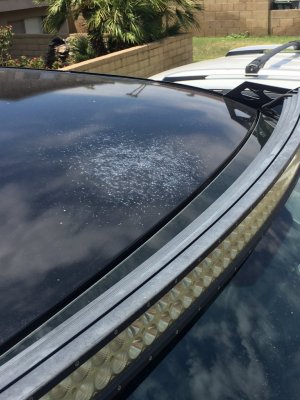

That my friend is extreme deterioration of the clear layer. There is nothing you can do to fix this problem except to repaint the truck. But like mentioned above, maybe do nothing to it to sell it. Here in Arizona, it seems any Foreign car after 5 years old is like this. Toast.
Also good to wax/seal twice a year.
You could spray the roof and hood with plastdip to help stop the spreading.. but it will show through the dip as texture.
