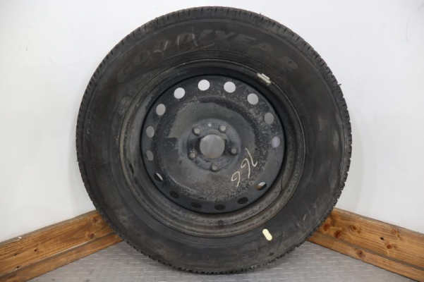

car-part.com search2 2016, dodge ram 1500 94 and up, wheel (display with image), your zip code, select spare 20", search
example of my search nabbed this
