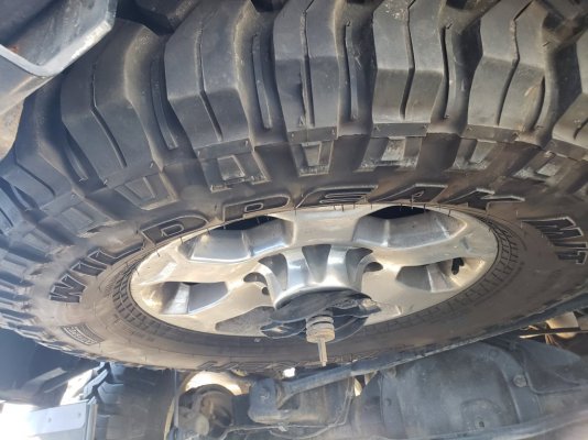

Brian2081
Jun 4, 2019
401
256
Weatland Michigan
Hi Socal, I have a 35 12.5 18 Falken MT on a factory aluminum rim in my spare location under the truck at 50 psi. Snug fit but fits.
