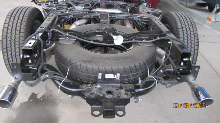

I have always thought that the black thing that fits into the wheel, could be modified in some way to hold an Alloy Rim securely in place.
Tires on the ground are 20"
If you look closely, the spare tire is plainly marked that it is a Temporary Tire
The Class 4 Tow Hitch comes close to touching the spare tire
