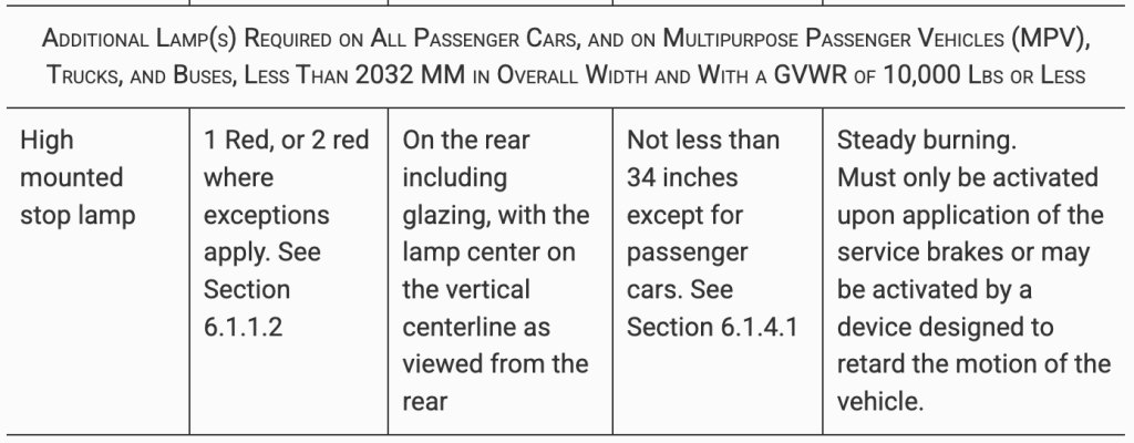

PSA: Flashing CHML's are illegal. Some modulating CHML's are legal.
Not in all States. I used the Z Automotive module to activate the CHML on my ‘24 Rebel, no issues. I also have flashing brake lights on my Harley. Have for years in Md, and now in SC.
Not illegal in either state.

No in all States. I used the Z Automotive module to activate the CHML on my ‘24 Rebel, no issues. I also have flashing brake lights on my Harley. Have for years in Md, and now in SC.
All states must follow the 108 standard. I didn't say anything about selective enforcement.
Stop lamps, including the CHML, must be steady burning. However, as mentioned above, pulsing or modulating has been recently approved.

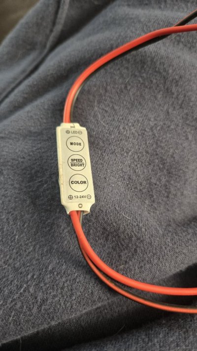

I triked my goldwing and did an led conversion. A there little units wired inline that allow me to choose one of many patterns... when I get home from work I will post a picture....worked very well.

1000009828.jpgthis is what I wired inline for my trike brake lights. Worked well....if I can locate a link for it I will post
