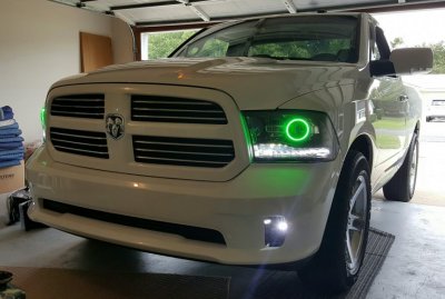

I just, just , got My headlights back in My truck after a few months chasing flickering DRL'S. Everything else worked fine, but the driving light would flicker when the truck was running.
A new driver solved the problem.

I see, that your foglights are running, too. So you selected DRL on fog lights I guess?
Booms
The OG
Aug 3, 2014
2,332
1,245
Ocala
2015 Express
Whipple 5.7 • SmoothBoost!
No, the fog lights were just turned on. The DRL's operate regardless of foglights on/off.
