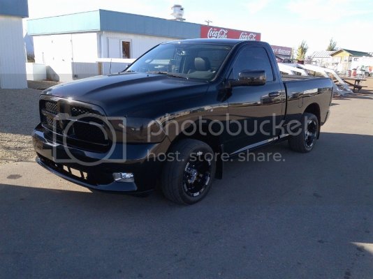

I have a 10' RCSB 4x4, 3.55 gears, stock ran 15.3's in mid summer heat
My first 13 slip was a 13.89/98.5 at 2500' DA
Only mods at the time were Airaid intake, Magnaflow CatBack, 180º T-stat
Diablo 93' canned tune with maxed out shift points and DR's
The biggest help was leaving the heavy 20's with 305/50R20 Terra Grapplers at home
in favor of 28" Mickey Thompson DR's on light 17" wheels all four corners
That took my ET's from 14.3-14.5's into the high 13's
If you have a 2wd, a 4.10 or 4.56 gear swap would be your best upgrade
It was out of my price range for my 4x4, so I went with smaller lighter tires instead
for half the cost of a swap for front/rear on gears.
My effective gear ratio dropped from 3.55's to 4.25:1
plus I had waaaay better traction.
If you get the bug for some real performance
toss a turbo or a supercharger on it :naughty:
Used to get a second gear chirp in 4WD, just before the stock trans took a dump

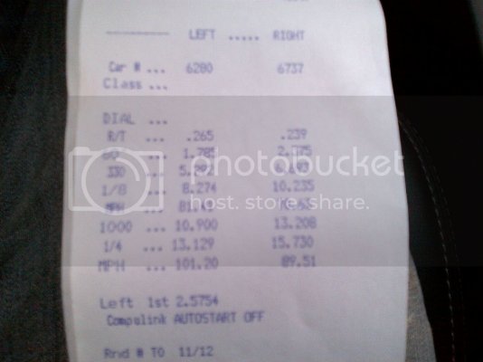

My best time on 3.55's was a 13.129
the day before my stock trans threw in the towel...haven't been back since
So close to the 12's too
