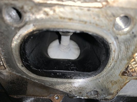

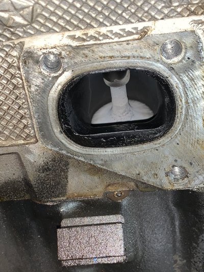

went for the exhaust manifold gasket replacement. It was only getting worse causing performance issues and the truck was having the hardest time wanting to accelerate or even power up a hill unless I mashed the pedal. Got a lot of carbon built up. Behind the manifold there’s a white residue built up inside is this normal? Also how can I clean manifold and the residue?

Thanks for posting, I will learn with some other guys on this one as I don't have a clue. Isn't the fail sage spray carb or brake cleaner on it? Have you ever pulled and checked the exhaust spark plugs and seen how they are doing? Gas burns dirty, so I would have to guess normal. One of those different? One no white residue or is that shade?

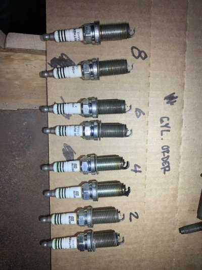

One of them is dark. Cyl 4.
The rest look like they are covered in frost. I’m about to pull some plugs and check I’ll post back.

By chance are you running an octane booster in the fuel,as the white ones look like what you'll sometimes get for residue with certain brands of fuel or octane boosters,and like has been posted #4 looks like it's burning oil,either valve guides/seals or weak rings.It might be worth while doing a compression check or better yet a leak down test if you have access to one

Looks like the white ones have regular fuel additive deposits common in some of the commercially available gasolines today, or fuel additives you use. The black one looks almost like it's sucking all of the crankcase pressure on that downstroke. Just my observation.

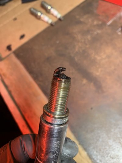

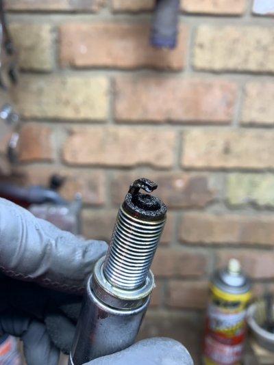

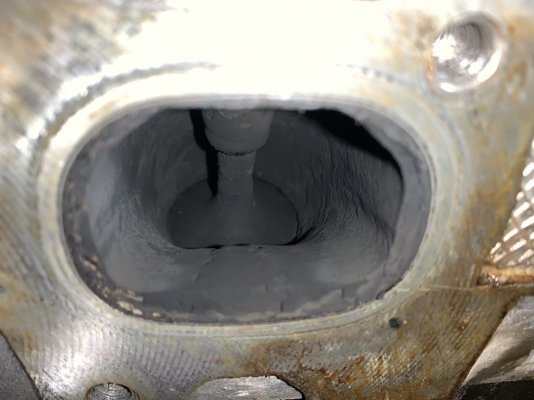

Okay guys I got around to it and this is what I uncovered. Cylinder 4 is odd. Can I clean up what is causing this issue? I’m going to replace cyl 4 spark plugs with my used ones if I can find them, not that they will last long without looking like these…Any idea what’s happening?
Do a compression test while you're at it,as #4 looks like it's got a few issues,that i don't think changing oil brands is gonna fix

It could be seal on spark plug tube? I would expect more oil on the plug but it is possible and a known issue. I always say look downstream and sometimes take flack for it, but if you find out this is the cause replace pcv as well. Pop that plug again and stick you finger down there, is there oil all over the finger? compare it to the next cylinder as well.
Man the other plugs look so good, seams like a small thing here. Valve seal other likely cause.
Look into redline si-1, we have 3 boroscoped engines here that show it disolves carbon slowly if that is the issue with the valve seat. Maybe prevent it in the future? Unless there is some other reason that failed if that was the cause.

Not seeing any oil on my finger that would suggest a leak into the tube or anything. There was no sitting oil or anything in the tube before spark plugged removed. I can see a considerable amount of carbon gunk just down on top of the crown. I’d like to remove it and maybe pour some sea foam down in there to help dissolve it while the motor is running or something. Trying to find the best way to remove as much loose carbon as I can. I poured maybe 3-4oz of B12 in last night to help loosen some up and considered maybe taping a clear hose to my shop vac and sticking it down in the tube and see if I can extract anything. Or a pump of some sort. Last resort would be my long handles air compressor gun and just let 100psi blast in and see what comes out and makes a mess. Not sure on what to do but I do need to get to work tomorrow so the truck needs to run by the morning haha. Any suggestions on removal of the build up and what I can put in? The owners of the truck before me did NO maintenance to the truck at all. Since I’ve had it I’ve tried to restore it and help the health best I can by cleaning up intake and fuel system with adt. And what not. Could using additives and decluttering the system at such high miles after it not being taken care of cause an abundance of build up all at once?

It is one cylinder is the issue, I think is valve related with what you said. If somehow the pcv was dumping in one cylinder over others, maybe a catch can will fix it, but this doesnt sound very plausible, but catch can can only help here.

Or valve seat, or something there is letting oil through. Maybe just thinking, does anyone think this could happen of that injector is clogged? Causing poor atomization not allowing pcv burn off.
