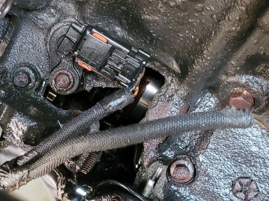

Oil pressure could just be the sending unit. I would stop all driving of the truck until problems are identified. DON'T BE LIKE ME20230211_105903.jpg

Sounds more like a oil pressure sensor issue,if it starts and runs with-out the lifters rattling big time. Pull the starter relay and jump it,that way you can do everything from under the hood,with-out the key being on,and the truck trying to start.Hook a battery charger to it,so it'll spin over decently while you check all 8 cylinders. A remote starter switch is handy,but in a pinch you can use a short piece of 12G wire to jump the starter relay
