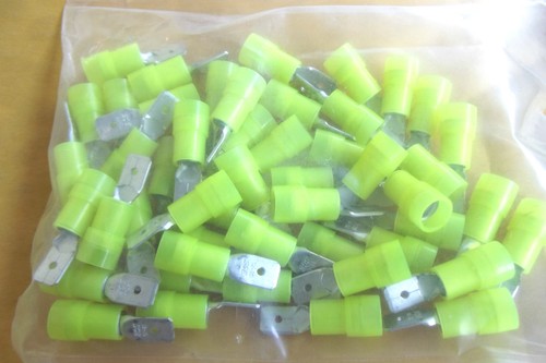

While you're at your local parts store picking up a stethascope,grab yourself a remote starter switch ,and a couple of 12G 0.250" blade connectors.Then you can pop out the starter relay,and push the blade connectors into #30 and #87 terminals of the relay socket,then hook the remote starter switch to the blade connectors,and use the switch to turn the engine over to do a compression test,with-out pulling the fuel pump relay/fuse or worrying about the truck sending power to the coils and trying to start on you,as you leave the ignition inside the truck off. You don't have to mess around with the fuel pump relay,or have somebody inside the truck hitting the start button,if you jump the starter relay,as the only thing getting power is the starter when you jump the starter relay
You only need 2 of this style blade connectors though,i'm just using this to show you the connectors that you can push into the starter relay contact points in the fuse box.Use a lighter to heat the plastic part of the connector,and it'll pull right off,leaving you a bare metal connection point to hook a remote starter switch to.
