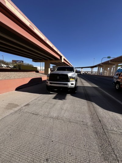

Hi, good afternoon I just wanted to see what you guys think the issue can be so I recently have been having issues with my breaks. So, I replaced the break rotors and break pads then, they started to squeak so I just brushed it off and now I had the abs light blink like crazy as shown in the video and to break I really had to step on the breaks all the way to to get it to start to break. So, I replaced the break booster and it worked for sometime but, every so often the same issue comes on where I have to press down on the breaks all the way and, the traction control light stays on and when the truck loses control it blinks at me “service electronic breaking system” what else could it be thanks in advance (also what can I do to get the low coolant to stay of I’ve replaced the sensor and it always has coolant what else can I do to get rid of that light)
