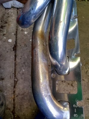

That's how the header look after about 50miles and a week on the truck. Ceramic coating dosen't seem to be doing it's job well...
