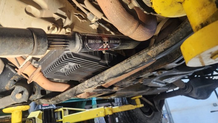

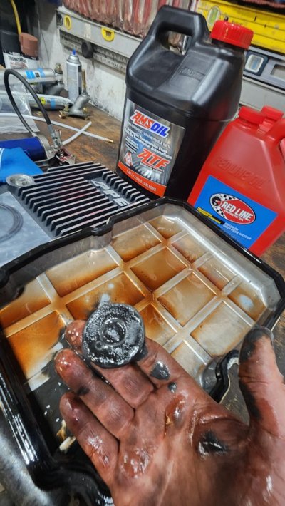

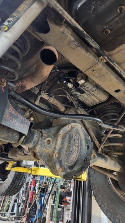

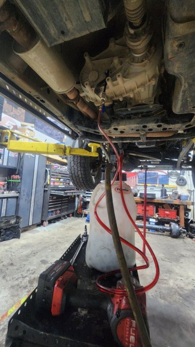

Swapped out another 4L today out of the Nag1 and did the T-Case as well.
Should be good another 80K
Side note, should've gotten this type of air pumps years ago.
Now the fun part since all this nonses preventive maintenance is out of the way.
Need to build an air tank mount were the muffler used to be. :driver:
Getting ready for Air Lockers and air horns of course :devilfinger:. I can't have a vehicle without them.

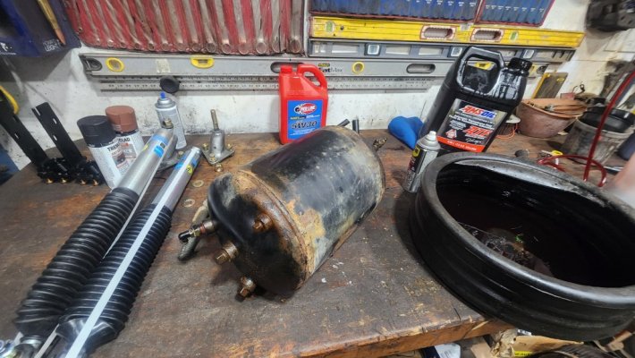

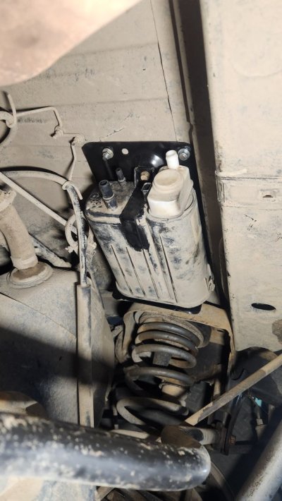

Evap Canister relocation. I hit it a few times last year wheeling. And this was on my list of thing to fix. Not sure why the ******* Jeep at put it so low.
This MOD didn't cost me anything since I had everything on had. But if you don't shouldn't be more than 20$ worth of stuff.

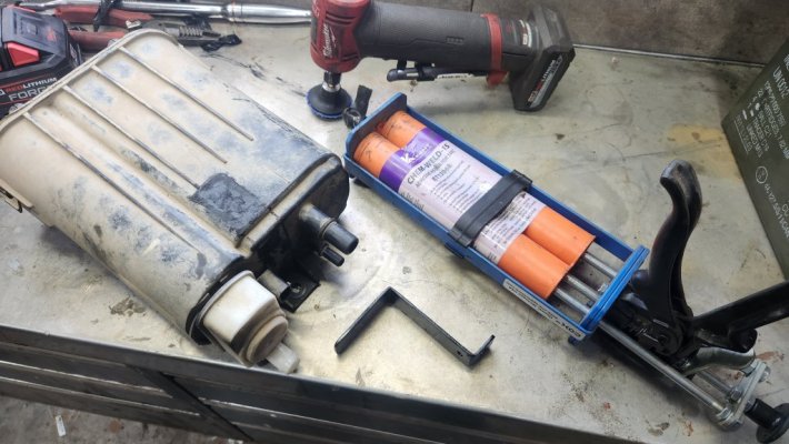

- trim down the OEM canister mount.
- weld nut on back
- Drill 2 new mounting holes
- Paint
- make a small support bracket.
- epoxy braket to canister ( this it's totally not needed but might as well do it right if you have it apart)
-Cut and fit hoses back on.

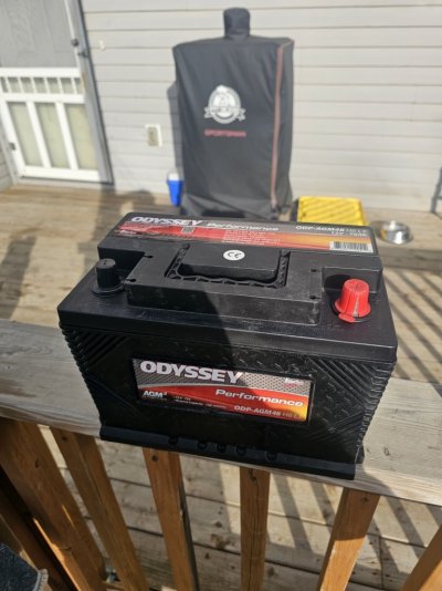

Winching killed another one, So Just like my truck it was time for a real battery ;)
I'm sad they are no longer red. Now I look like a poor with a regular battery when I open the hood. :dogpile:

Am i the only guy who's not impressed by an odyssey battery.I had 1 in the trunk of the 1320,and it didn't make it 2 years before it was garbage.
tjfdesmo
Apr 15, 2014
2,852
5,558
AZ
I was told directly by an Odyssey rep at a dealer expo that they need a higher charge voltage(higher than ordinary AGM)than a vehicle provides and need a regular maintenance charge with one of their chargers. This used to be spelled out somewhere on their web site, but I don't know if it still is.
grizzstang
Apr 26, 2017
1,848
2,895
Calgary, Alberta Canada
I have had an Odyssey 49-950 H8 in my Ram for at least 5 years now, maybe longer, I will have to check.
I had one in my F150 before that was 8 years old when I sold it and still working fine.
No issues so far in my Ram but I do plug it into the Battery Tender once and a while to top off the charge.
The red battery was their thing, I am not sure why they would change that.
