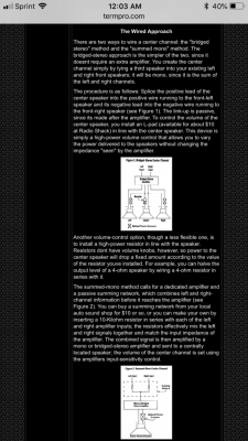

At least now I can add one of my JLs to the middle of the dash, just need to figure out how to power it. Either gonna run it off of my alpine 18 rms radio (JLs are only 25 rms) or run it on one of my rockford amp channels powering my infinitys. Not sure if that will make one infinity sound louder than the other.
These are the options for powering a third center speaker. Since the alpine 3.5” is only 25 rms I am thinking it would be best to just run it off of my radio.
http://www.termpro.com/asp/pubs.asp?ID=115

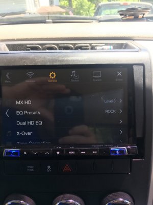

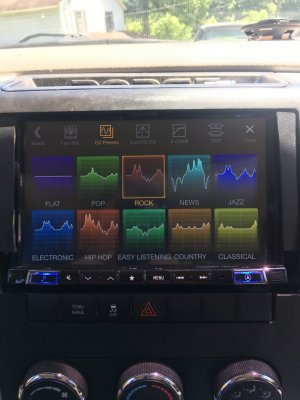

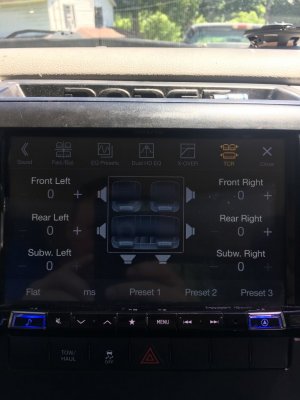

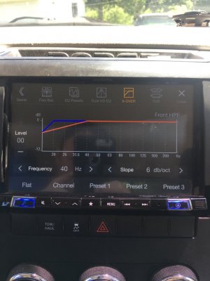

Now i just need to figure out how to turn down the bass with my alpine EQ and crossover. Its pretty advanced and complicated. Too much bass going to my components and rear rockford power 3 way 6x9s.

The biggest thing is in the second to last photo. Change the HPF to 80 and slope as high as it goes (prob 18 or 24). Repeat this for the Rear HPF as well.
Also a contributing factor is you are significantly boosting 63hz. I would dial that back a bit. I know you are after volume, but some of the best advice I have received is never boost but to cut around a peak.

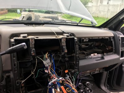

Any idea what FS means? Im going to try adjusting things tomorrow with you guys suggestions. I ended up pulling the whole dash out and running a wire from my alpine radio to the center dash speaker, and put one of my JL audio 3.5’s there. The silk done tweeters on the JL 3.5s arent actually bad. Dash needed to be pulled anyway so i could run the wire to the top of the center dash speaker cover for my alpine GPS. Wow what a job pulling the dash was! Took damn near all day! I had to remove like 40 screws. Passenger air bag was what made it a pain in the ass to remove.
