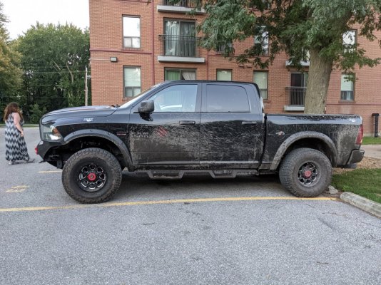

I have a 3” body lift on my truck and the Fox 2.5’s give me about a 2” lift. Plus the 2” wheel spacers push the tires out further. I’m also running a very low profile Bumper which gives me quite a bit of room for my front tires. If I could have been at the shop when they did the installation of my new shocks I would have had them articulate the front end without the coil overs on just to see where any issues would arise regarding wheel travel and rubbing.

I was more referring to fender contact with the 13.5" of travel if you are able to replicate a long travel kit :). But having a 3" body lift might be the solution! I think fiberglass fenders give you a 4" rise in fender clearance height over stock to accommodate the long travel.
