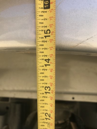

I can tell the difference in the handling department as with the Superlift the rear had definetely more body roll, Icons can for sure manage the weight i have in a better way as the rear feels more planted everywhere especially around corners. Took the truck to my local testing ground to shake those spacers and make them settle. As expected the rear is back again to 41" (40 7/8" if i'm going to be picky

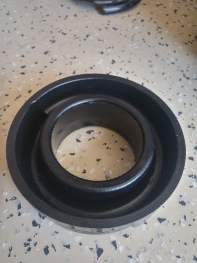

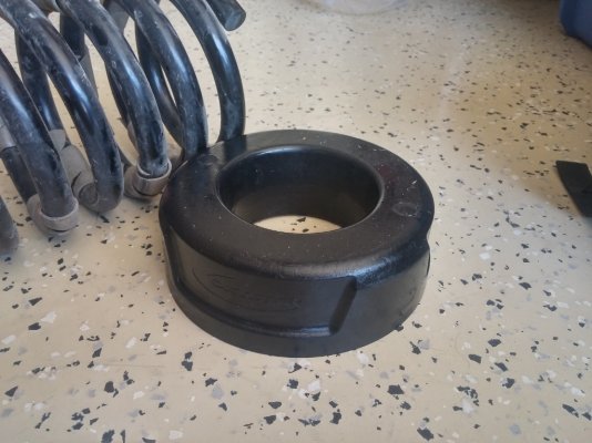

These are the spacers, plug and play just remove the factory isolators and plug this back in, they have the groove for the coil to fit it like a sock

No need for TB bracket anything, handles the same as before when the rear was 1" lower, axel is shifted 1/8" so the difference is nothing ill ever worry about.
