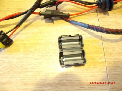

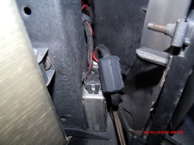

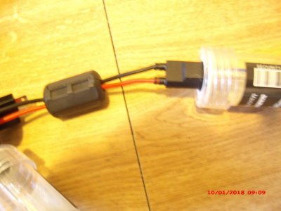

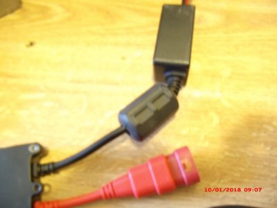

Here are photos showing what the part looks like and where the placement is. I have a set of lights for a friends truck, so I showed the placement with them laying on a table. The first pic is showing placement on my 2004 ram 1500. If you look close you can see two ferrites the one in the foreground is on the "bulb" side of the power supplu. The one above it , partially visible is one the power side. Any >> just ask.
medicineman
May 31, 2015
27
6
4.7
Sir John,
No insult intended. There are many types of ferrite materials and some do not insure the desired outcomes.
I don't know if you tried installing with the radio on and tuned to a distant station or not. That is what I did, I disconnected one side of the lights at the transformer and I slid the ferrites along the wire till noise left and signals came in. Then I disconnected the ballast transformer on the side completed and did the other. I had to actually loop the wires through the bead and close it on one wire to get the job done. takes a little work, but worth the effort in both listening pleasure and great lighting for night time driving. i noticed that one person said that all ballast for HID's were junk. I don't believe that, as mine have been in service for quite some time and my lights come on dim with engine start up. My background is in both electronics, being a GROL with RADAR endorsements 17 years and a 38 + year Law Enforcement officer. If I can help or suggest anything you think might be of help just let me know.
