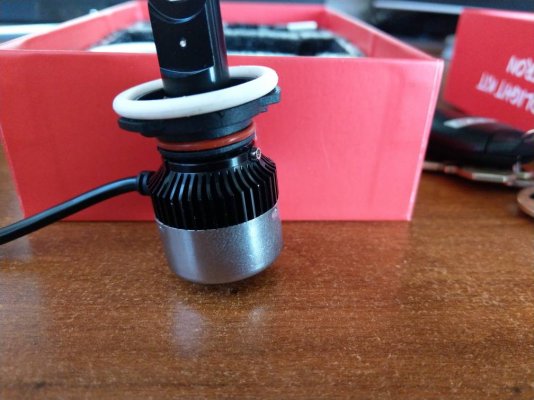

Quick question...is that bulb the stock bulb and if so is it labeled 9145?OEM vs the one I ordered..View attachment 148432 View attachment 148433
Everything I've looked at shows them as interchangeable as well. I want to say my stock bulbs for the vertical fogs on my 2014 were 9145s too. I'll check my shop tomorrow to see.It sure is! Well that may explain the issue. Strange because I have tried other 9006 LEDs in there before and they fit. Also every "bulb finder" site I have been to said it was a 9006 bulb. Guess I should have looked at the OEM bulb itself.

Oh my bad. Yeah I have never seen that issue before but then again I focus mainly on headlights. Sucks you can't get it to fit.It's not the tabs that are the problem, it's the diameter of the bulb where the gasket is. Like I stated before I have had other 9006 bulbs in there but these HIKARI bulbs don't fit. Go back up a couple of posts and you can see the pictures I took and see what the issue is.

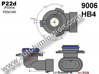

You can see in the specifications of the bulbs below. The 9145 has a 20mm diameter and the 9006 is a 22mm. My guess is some 9006 are a little under or the hole in the housing is slightly bigger so they fit while others don't.

I had the same issue on my father-in-law's 2012 1500. "If" that inner ring was a little larger it'd fit like a glove. I think I'm going to try a 9005 and see how that fits.So I just went out and measured the hole in the fog light housing itself. It's approximately .794 so with the light being .878 in diameter there's my problem. I guess not all 9006 bulbs are created equal...
Well I did dig out the exacto knives set I have for another project...maybe I'll whittle away at the Hikari base until they fit?A 9005 shows as being the same diameter as a 9006 (22mm) so not sure that would fit either? May be luck of the draw. Seems like the 9145 is the correct bulb but less choices on that one.
Understandable...I have an O-ring kit and some dielectric grease which should do the trick. I'm also tempted to find a set of housings and modify that for him...I thought about that myself but was concerned about how well the gasket would seal if I did that? Don't want to get water or moisture in there. We get a lot of rain here in Georgia.
So, what do you think? I don't have a horizontal fog light to try this on at the moment, but I just pulled the seat off and flipped it around, then grabbed a pair of seals off an old set of 9007 bulbs I had lying around...I thought about that myself but was concerned about how well the gasket would seal if I did that? Don't want to get water or moisture in there. We get a lot of rain here in Georgia.
