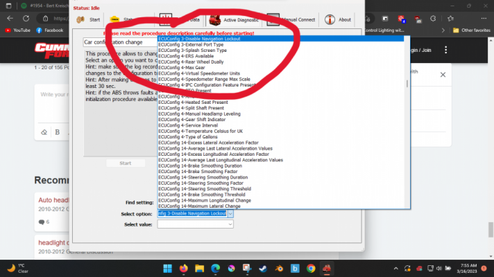

Can you verify this and ask your friend what changes were made? I've tried with negative results.

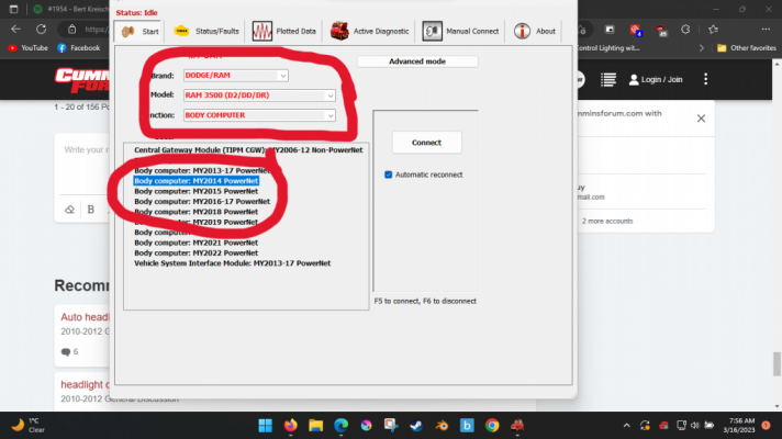

Hey Good Morning, This is what my coworker sent me this morning. He said when you get to Navigation Lockout, Select YES. He said it disables the lockout and lets you control Nav while driving. I hope this helps
Thank you for posting that info and thank your co-worker. But for 2018 it doesn't show that option atleast on the mobile app. I won't be able to look deeper until Saturday.
I’ll check this out myself from my laptop. Would be nice if this would work.

Just checked it out, can’t be done on my 2018 1500 Hemi. The setting to change that isn’t there.

Sorry guys, when I posted that it worked I didnt realize it was for certain years. He did mention he had to reset his Radio/Media/Nav after he made the change. Maybe that will help?

I just checked out my 2021 2500. There is no option to toggle that in the BCM module. Would have been nice.
