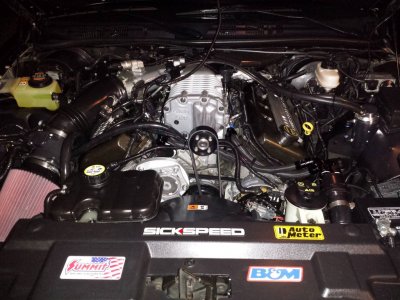

I went from 3.55's to 4.10's on my Marauder. It now has a little whine but I can hardly hear it above the sound of my headers, Magnaflows and supercharger. LOL
