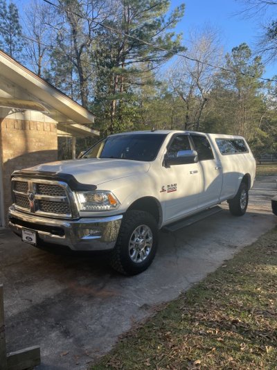

This morning I pulled the FOB out and I got the key in ignition chime, so I put the FOB back in and turned it on and back off and everything was fine then. I could care less now because it is going to the dealer today as a trade in.
I bought a 2018 2500 crew cab, long bed, Cummins yesterday.
18CrewDually
Nov 17, 2019
2,421
3,414
U.S.- New Jersey
Cummins 6.7 H.O.
Good find. Especially if you're in the need of the long bed.
