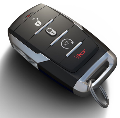

My 2016 Ram FOB, has to be inserted in the Ignition to Start
F.O.B. is shortened from frequency operated button, but it is actually shortened from
FOBIK is shortened from . Finger Operated Button Integrated Key
Smart FOB, also called a RKE, Remote Keyless Entry
it never has to leave your pocket or purse

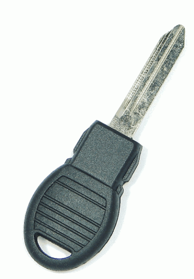

the 3rd type of Dodge Key, is called a Transponder Key
It has a CHIP in it, that communicates with the Ignition
ppl use them if the are doing things like water sports, hiking, para gliding

Ram calls it passive entry and lock. It is not available as an option at all on Big Horn and Tradesman trims, and is a standard feature on all the rest of the trim levels.
You can add it yourself after the fact.
