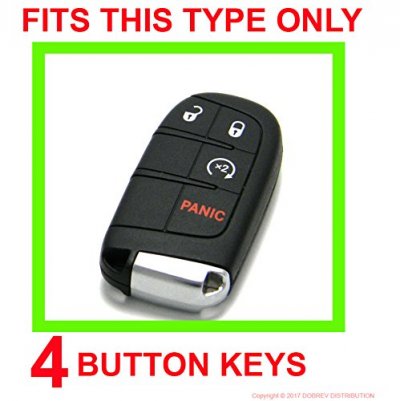

I have key less entry, and push button start on my 2013. Both of my fob's came with a door/tailgate key attached to the fob. Since the fob's themselves have a "valet" key built in, is there any need to even carry the full size ? I have searched the site, but unless I missed it could not find a good answer to my question. It is the 4 button fob that looks like this.
Thanks in advance.
Jim

The full size keys are good to “ Leave 1 at home & and hide one on the exterior of the truck” that way you have guaranteed means of access no matter what. At least that’s my opinion-

The only issue I see with hiding one key on the truck, is it only gives you access inside, you still could not drive it w/o the fob ?? Even the idea of the "valet key" doesn't make sense since you can't start the truck w/o the fob. I miss my 95 Dodge for this reason, one key and not "chipped". Could hide one on the truck and it would let me in and, let me start and drive the truck. Am I missing something with this set up ?

If you open the door with the key without the fob you will set the alarm off.

quietpeen is absolutely correct.... how do i know....? because it happened to me... and the anti-theft mode will not let you start the truck either.
If you hide a key fob (w/push button start option) within the chassis, anybody can easily steal your vehicle very easily, if they get inside of the truck.
I`m not sure how far away the fob has to be from the truck to still be able to read it, but i surely wont chance hiding a fob anywhere outside of the vehicle.
First rule of thumb, don't lose your key fob!

If you must hide a fob, remove the battery and the proximity feature will not work to access the cab nor keyless start.
Remove the blade to access the cab. Your alarm will go off but if you push the corner of the fob against the start button the module will read the key, the alarm should stop sounding and start. You then live with the chime that your remote is not present until you switch the truck off.

AFAIK you can use the fob even with a dead battery to start the truck, you just have to push the start button with the fob itself. Which means you need to know where the fob is in the truck, so its an OK way of leaving the truck for someone else to pick up.
Good call about removing the battery from the fob, otherwise someone could just touch the front door handle it presumably enter the truck (since the truck sees the fob within range)
