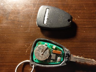

I know what it looks like lol. So yours looks like this with the battery in place?
Nine times out of ten it's because the fob wasn't put back together correctly. If you're very sure you did, then that leaves:
1. Possibly incorrect fob battery
2. Diminished signal strength; shouldn't be an issue with fresh batteries but might be worth testing to make sure they hadn't been sitting on a shelf too long. Requires special tool to verify signal.
3. Lost programming; highly unlikely, they are designed to stay programmed to the vehicle even if you pull the battery in the fob or vehicle.
4. Your keyless entry module has taken a ****; this will require pulling the cluster to replace, as the module is on the back side of the cluster.
