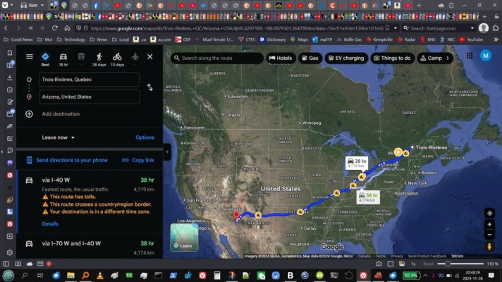

And you trust everything that google tells you ?
As the saying goes, believe nothing you hear and only half of what you see
Well a paper map or a globe would also tell you they aren't exactly close if Google is beyond your comprehension :rolleyes:
If your in Michigan,you should know where Quebec is,it's north east of you,and you can't be that dumb you don't know which Canadian provinces you're close to :Big Laugh:
Youd be surprised
I didnt grow up here, and i know canada is up north, but ive never been there
Truth be told, my European topography is better

Youd be surprised
Yea nothing surprises me about the US's school curriculum anymore,it seems to leave abit to be desired about anything outside the good ole US of A. :cheers: :Big Laugh:. Even still you should know where Ontario and Quebec are,Windsor's just across the river from Detriot
I only took college classes in the US, not a whole lot of topography in that
