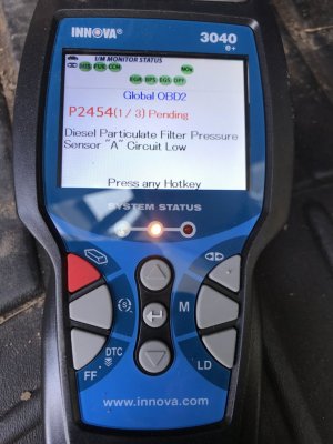

Plug in an OBD scanner, should be the first tool purchased by any vehicle owner.

I wouldn't think that code would cause the truck to die and not do anything.
Start looking under the truck for wiring connectors that have loosened and/or can apart. There was a guy with an EcoDiesel had a similar thing happen but he drove through a big water puddle fairly fast. He found a wiring harness came apart inside the frame rail.
Also check the BCM connectors under the dash, it's to the left of the steering column.
