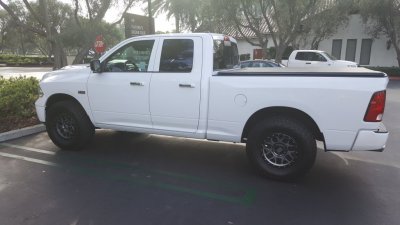

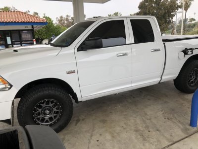

Hey Guys! I am new to my 2015 Dodge Ram 1500 Big horn and I believe it currently has just a basic l leveling kit as it’s running 35’s. The front does rub sometimes when the wheel is Maxed out Right/left. I am looking at upgrading the suspension to Kings.. Where do I start? What do I need? What do you recommend from Kings?

I’ve always heard great things (Family all runs King’s) and they are super local which I like.
What product from kings should I be looking at on their website? Do I only need the front setup or both front and rear? I want the ride to be nice on the street as well...

I am considering Fox now after talking to a few buddies. Unfortunately they don’t have any dodge trucks so they couldn’t help specifically with which parts exactly..
I’d like the truck to drive like a caddy on the street but be able to handle blue moon off roading. It is not a 4x4.

I believe there are some spindle lifts for 2x4 trucks, but I am not sure. So what it sounds like you want is a mid travel kit “to clear 35”s” and a little added travel with better handeling characteristics. Reach out to CJC offroad in SoCal and see what they have, they do a lot of Long travel kits and do a lot of Carli,Theuret stuff. I take it you are in SoCal?

The problem he is going to have is it is 2 wheel drive. Not a lot of selection for 2x trucks, icon doesn’t even make a kit for them. The front isn’t even a coil over.
Cst appears to have the most 2wheel drive solutions for ram.
