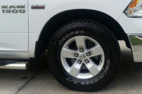

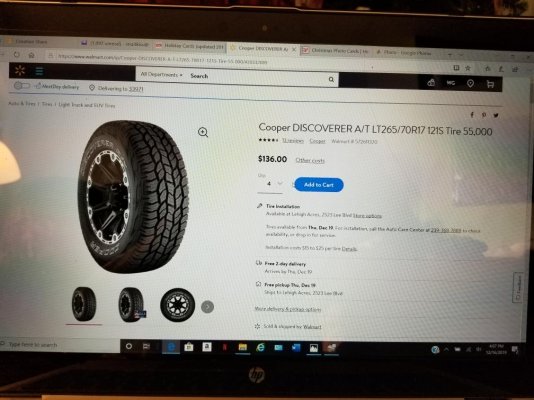

I ran Cooper Discoverer A/T "E" rated tires from Walmart. Got over 81k miles out of them, and they cost me less than $700 for the set, otd w/road hazard.
Now that Goodyear has bought Cooper, have no idea if the equivalents are as good.
Have heard that the Falken's are excellent.
