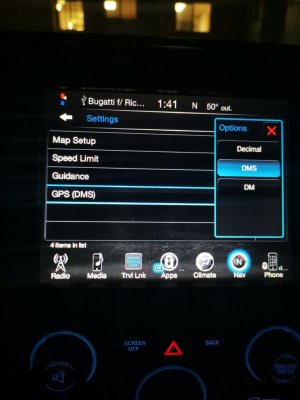

This is what I selected, not sure what it does, but worked for me.

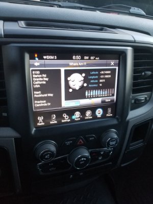

Not sure if this even does anything. Was trying to find info on it But when I selected I it, my maps were stuck on Cali where the trucks radio came from Right after selecting this it updated my location in WA. Might have been coincidence but can't hurt.
