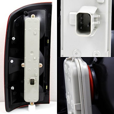

Probably the taillight circuit board. You can get it at a parts store.

Definitely the circuit board, but I will tell you it still happens even with a replacement. Put some dielectric grease in that socket and turn the bulb around.

Yep. Circuit board!
Almost lost my kind after replacing though. I accidentally put my LED reverse light in the top slot (turn signal).
My wife was behind the car, confirmed the brake light was working, so I put all the bulbs back in (incorrectly), buttoned it back up, turned on the car - LAMP OUT LIGHT still on. Checked the brakes, check the tail lights, checked the hazards, then turned on the blinker...hyper flash. Trouble shoot, yada yada, wrong bulb wrong slot. Alls good now. Thanks everyone!

Where is this circuit board located on the truck?
Oh, how not intelligent of me.....Sorry.
Karlsweg
Nov 10, 2017
1,025
950
SW Florida
It’s where the light brake/ tail light bulbs go into. Take out the tail light housing and it is held in with 4 or so screws.
