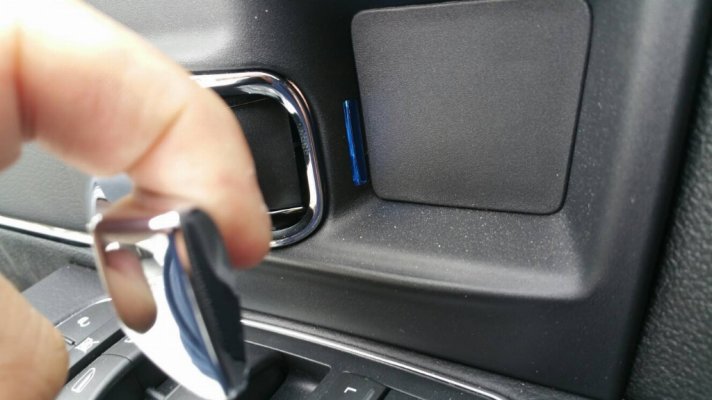

I took some pics of my Laramie door to show you guys what you're getting. I have the picks in my phone and I can't find the thread with the new Tapatalk format so I'll have to make this cheesy post first so i can find it in notifications. grrr

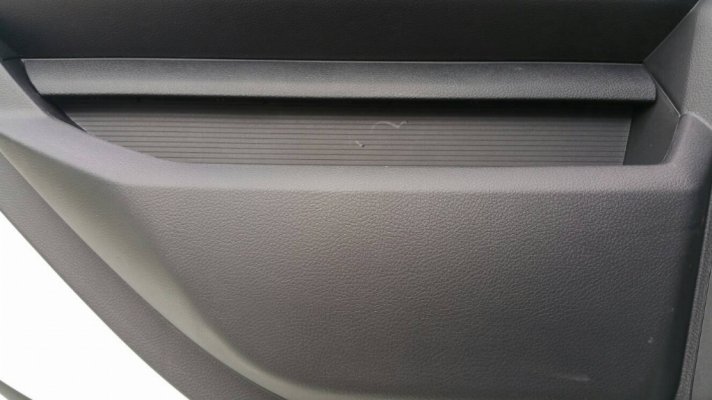

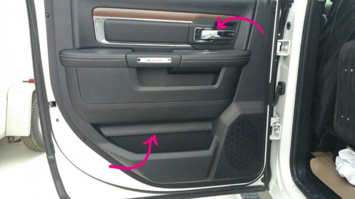

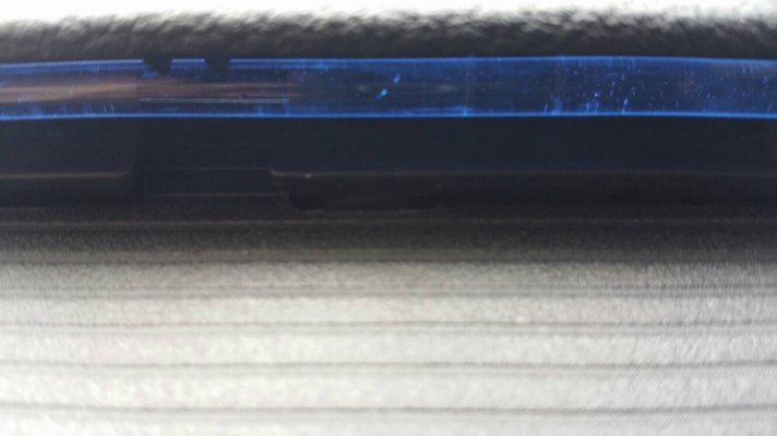

Okay the mood lighting comes from two [emoji111] places in the door. Behind the handle and above the storage pocket glowing down into the pocket. It looks like a cut out in the back of the door handle and there's a plastic clear lens with a dim blue light behind it. For the storage pocket, it runs the length of the door. 62df5fd8f8f11b5e9c734c992b5bc7c6.jpg2f726654d3c051a1883ac8d18cbb7ccc.jpg812650cf2f9049666a630770528fe92b.jpg29fc9b4675ed00802a39ff739be9aead.jpgf97edf9a37832bf9605c5acf130d6a08.jpge51c97a81cc6df5652bb9ea93a9d50a8.jpg
The last two [emoji111] pics is for the pocket and to get the light I put my phone in the pocket and pointed the camera up.
This is awesome, but any chances you'd remove the panels and show that they plug into and any module pn's?

So what kinda light is behind there?
Doesnt look like just one LED. Maybe a super bright one focused in those two spots

Unfortunately I am the sole caretaker of twin 2 year olds while my wife is out of state taking care of her sick grandfather. If it were something I could do really quick I would consider it but I can't. What I can say about it is it does not look like one bright light, it just looks like one regular led light that shines into the clear lens and the glow of it likes the Door. Like optic cable passes light. At most there's one light on each end of the clear tube for the back door and probably just one light that lights up the door handle. My best bet is that it's not an accessory that you can add but part of the Laramie door package when they install it it probably comes as one unit with the door interior. I really don't know if they can sell the part because it may not come separate from the door panel. They may just sell a replacement LED bulb. Then again my wife tells me I'm wrong all the time.

On second thought, you could probably achieve the same glowing light if you just grinded out a section of the plastic and installed an LED strip light behind the hole. I'm sure you could certainly get a 12 volt power source in there.
