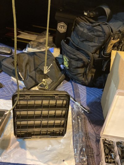

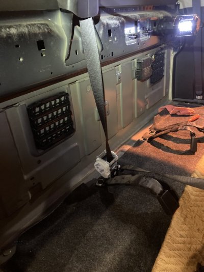

I did mine a little while back, the hardest part was the bolts for the seat, after that it was not too bad.
I used the string method, I read about here, to lower them into position & then grab from the inside to click into place.
It was probably 2-2 1/2 hours total, not in any rush, with the majority of that removing the seat bolts.
I was sweating by the time I got the last one out, started with my biggest socket driver but ended up using an old-non ratchet- torque wrench that has a long handle.
If I did it again, I would go underneath and spray the bolts with some “blaster” or similar a couple times prior to removing the bolts, safe to say it was the first time the seat had been out on my 10 year old truck.

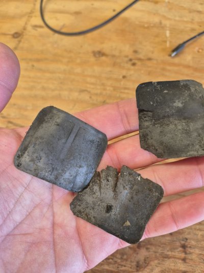

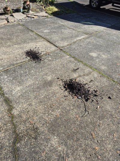

So, I got around to cleaning the crap out from between the cab and bed and was pretty surprised how much was trapped in there. I don't live in a particularly heavily treed area but I guess after 11+ years it adds up. And I'm not even sure the debris is what caused the leakage.
When cleaning the junk off the driveway I found a few of the flaps from the vents. Surprised at how cheap and flimsy they are. It's no mystery why they broke down and are leaking. Looks like I'll be redoing the vents in the spring.
Truck will probably sound a bit quieter, and less fumes.
