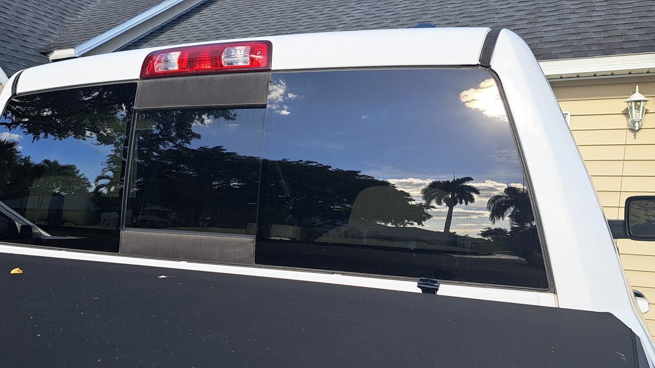

Update - still haven't got around to the project but have noticed something that is opposite of what I expected. I figured parking on an upslope would be worse as water runs back off the roof and over the vents (that are missing a bunch of pieces). Turns out it's worse parking on a downslope (especially with a bed cover).
When water runs off the bed and the truck is nose-low the water drips forward a bit and right against the damaged vents. When on an upslope it runs off the cab roof but the vents protrude a half-inch or so rearward and the water runs around them. Kind of like a chimney cricket for those of you fellow construction folks. We've had some rain and I've been watching the water when parked in each direction and it's far worse when nose-low.
Anyway, I'm embarrassed I haven't found time to fix it but I've got a bunch of life-craziness currently and just haven't gotten there. At least now I can let it sit without fear of water leaking in.
I would have thought the same thing regarding parking, seemed like there was no pattern to when mine would leak, I did put a rolled up towel under my vents to try to keep my carpet dry.
I would just switch the towel out after a rain/wash until I replaced the vents, it worked good for a temporary fix.

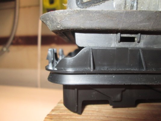

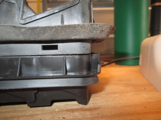

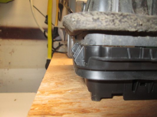

Finally getting around to this. Seats came out easy but it looks like Geno's Garage screwed me. Their vents are slightly larger and don't fit (see pics). I'm also a bit confused as some videos I watch guys talk about slipping them between the cab and the truck and there's absolutely not room. I've tried from the bottom, top and sides and it's just not going to work.
I guess I'm going to have to go bend over at the dealer. I'm surprised at Geno's. Their part is clearly larger with some extra angled bracing, etc.
I checked my Geno's receipt and they say these are for 03-26 2500/3500... I'd disagree.
I've slid the old ones back in a few times just to be sure I'm not a complete fool and it goes in, albeit a VERY tight fit but it does go. Any extra size like on Geno's and it's not going.
Update/Edit: Looks like it's not really Geno's Garage fault... Went to the dealer and the new ones look just like Geno's. Parts guy said they changed the design of them and I'm sure Geno's is just copying the new design. Parts guy said the only way to install them is from the back. Problem is I absolutely don't have the clearance. The best chance is from the underside but it's just not wide enough.
I've come up with a workaround, though. I'm going to use the frames from the original vents and glue strips of Tyvek house wrap to mimic the factory flaps. The weatherstripping around the frames got pretty trashed when I removed them and it's 12+ years old so I'll probably just run a bead of caulking around the inside to take its place.
Kind of ridiculous what a PITA this turns out to be.
Seems like we have similar luck, my vents went in easy but the seat was a battle, but sounds like you have a plan to make it work.
Hoping the rest of your fix goes good without too much aggravation.
