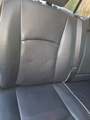

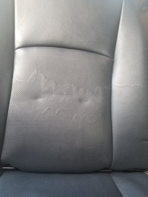

I normally keep my back seats folded up. They havent been unfolded in atleast 2 weeks. I unfolded them yesterday and one had a big mark all across it like maybe it got wet. Has anybody else seen anything similar?

To me it looks like something got into the holes (looks almost like a cleaner).

Ya i just dont get it. The seat has been folded up. If it was water why is it only showing in the middle of the seat instead of the bottom. The bench part of the seat doesnt have anything on it

Did something transfer from the seat bottom to the seat back? Like was there a stain or moisture already on the seat bottom when you flipped it up?
I wonder if the seat back would dry out and get back to normal over time.

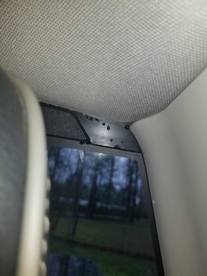

Its possible. I need to get that weatherstripping and put on there. There is a leak because the floor is damp every once in awhile. But i didnt think it was enough to soak the seat like that.

No it was dry. Somebody was setting in it is the only reason it was down. Its dry in the pics. The leather is raised in that zig zag pattern.

Oh. To me it kinda looked like the foam underneath puffed up from moisture, or something wet was against the leather and then "peeled" off it, lifting the leather in that weird pattern.
Also not sure what the white residue looking stuff is in the perforations. Sunscreen? Cream?

Your guess is as good as mine on what the white stuff is. I think it just left behind from water maybe. The seats rarely get used. Its not any type of lotion or cream though.

I wouldnt give up on it yet.
Maybe treat it like a wrinkle and apply a warm compress to try and shrink it....there is a YouTube vid from the interior guy at West Coast Customs where he microwaves a cloth in a bucket of water to get it steaming hot and then lets it sit on the wrinkle

I would venture 3rd brake light leak that the top portion of the seat was able to air dry quicker than the part folded up. My buddies did the same thing due to the brake light leak. Replaced the whole back seat under warranty thankfully.

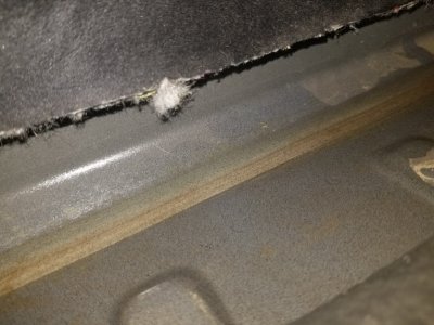

Well its been raining in oklahoma since about midnight last night and i went to check for water. Funny thing is the passenger side which is the side thats messed up is completely dry. The driver side literally has water standing in the back of the cab. The only place that looks wet above is between my headliner and window. Headliner is completely dry. The water is about a nuckle deep lol. The truck is setting fairly level and may even slope to driver side just a tad if anything.

Does anybody have any info on dropping the headliner? Once it stops raining i will pull the 3rd brake light and see if its wet behind it but i think its the rear window or the rubber gasket on top of the truck possibly.

FWIW your leak looks *exactly* like mine, which was the third brake light. One damp corner of headliner and a few drops of water on the black bezel around the rear glass. Mine didnt make it down to fill the underseat area (AFAIK), but once the dealer dealt with the third brake light, it didnt leak again.
