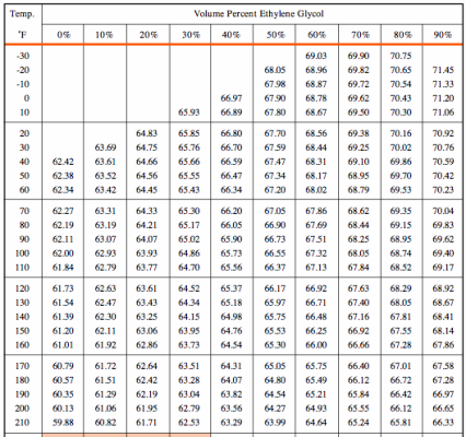

I think what you are seeing is the result of saturation of your mixture of concentrate VS water
Coolant is used to manage the temperature of water and if you have been mixing the coolant the exactly same , the variable would be either the concentration of the coolant you purchased or the percentage % of dissolved solids in the water you used.
Specific gravity chart
I understand what you're saying, and it makes a bit of sense, but the purple MOPAR coolant isn't ethylene glycol. Also, there are no dissolved solids as I used distilled water.
Ok the previous chart was to give the idea of the concentrations and not an accurate unit of measurement of all coolants but the point is specific gravity is a way to measure the coolant you buy against what you’re actually getting

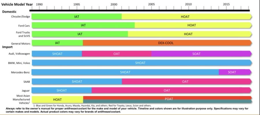

Below is another chart from a PDF for others to see what types of coolants have been used in the recent past from different manufacturers for their vehicles specifications.
