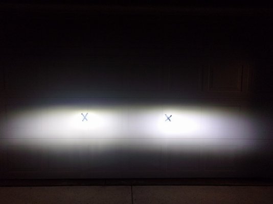

Here is with both headlights with Underground Lighting.
They are not the same height, but the hot spots are easier to recognize with the naked eye.
Passenger side raised to match. Passenger side is still off in color and focus, but Underground has severely lessened the issue.
During test drive I definitely see a cut off. Nothing like HID E-codes, but it's there.
These are focused enough that I am going to adjust them a little higher.
