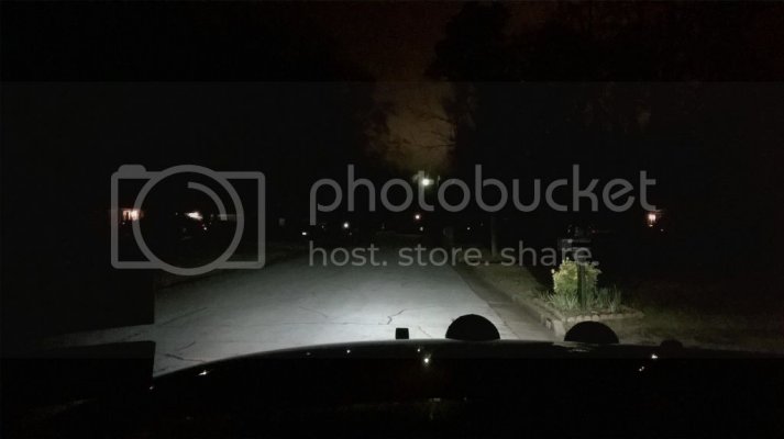

The LED headlights are a kit from SuperBrightLEDs.com. It's a LED version of a 9004 bulb.
Only thing you need is a set of housings that will accept a 9004 bulb. If you have projectors you'll either need to change or get a kit for the corresponding bulb (H11 I think). Directly plug and play don't need anything extra. Super easy just look at it and you'll be able to figure it out in a minute at the most.
