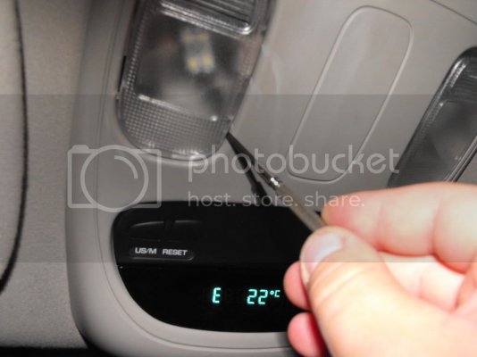

Marx
Marx
Jul 4, 2010
271
24
Southeastern Ontario Canada
Hemi 5.7L, 345 ci MDS
not sure about the sunroof console since i dont have one but my map light covers just pop off. heres some pics i just snaped
put the flat screw driver in straight and them pry the lens down should pop out
