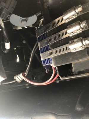

That said... for the fogs and the resistors, I found a tight little cubby hole right by the fog light housing that allows the resistor to fit very snugly. However on a recent road trip it came out and was dangling by its wire. Any suggestions on how to secure it inside the cubby hole?
Thx! Pics below on my latest setup.

Maybe send some pics of how you have them now? Depending on how you have them zip ties could work, that's what I used.

Zip Ties are plastic, and the resistors will eventually melt them.
You need to find a metal spot where you can mount them, even if only with one screw.

I've seen zip ties get brittle after time and a lot of temperature changes but I don't ever remember seeing one melt around something like a resistor.
