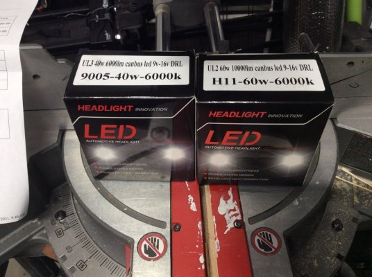

I installed these this past week, and what a difference. Super bright, no dark or dead spots, plug and play, clocked perfectly.
The only thing I found, is on the 9005 blubs, the o-ring is not as fat as the factory. Replacing that with the one off the old bulbs will take care of that.
I just wish I had thought of doing it before I finished...lol So, I have the factory AutoOne o-ring in. It works fine, just not as tight as the factory one. The H11 seal was fine.
Here is the kit. $59.99 on Amazon..Yes it's inexpensive, but expensive is not always better.

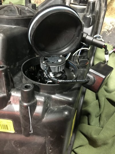

I finally installed led yesterday I went with auxbeam 90 watt q20 for low beam. For high beam I went with auxbeam 120 watt gx series. No codes and they work great!! I have projectors.

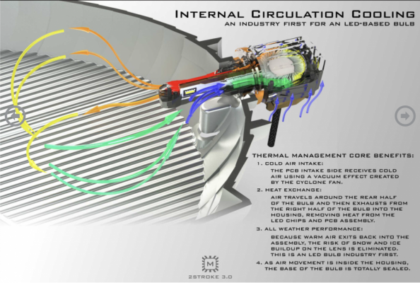

If you get some nice snow in the winter time, LEDs do not heat the headlights up and can snow them up. I put in some LEDS and snowed 3 days later. As the snow built up, the lights went from aimed to like an incandescent bulb and couldn't see ****. Had to stop 2x to clean them off.

The Morimoto's will melt snow on the headlight... they designed for that -- just fyi! :cheers:
