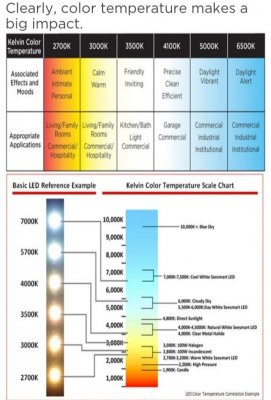

But you can pick any color temperature from orangish to very bright. Outside I use 2700k, which are very orangish, except on my motion sensor lights, which are very bright white 6000k. Inside some of the fixtures are very warm orangish, and others that I want to read by are bright white.
In my garage I had six overhead fluorescent fixtures with double bulbs in each one. I took all those down and put up four single bulb LED fixtures, and it's actually brighter now, and none of that fluorescent flicker. Also uses far less electricity.
In the motorhome with LEDs, I can have every single light on, and they'll be basically using the same amount of electricity as one incandescent. If I'm out boondocking away from electricity, I don't have to turn the generator as much, because they won't drain batteries as fast. Plus they don't really put out heat.
https://www.tcpi.com/what-is-lighting-color-temperature/

Thanks for the chart ! I always wanted to know the different K factors did to lighting !
I am running 6k in the cab of my RAM and it has a slight bluish tint to it ! Just like your chart :)
You made me pull a few bulbs in the house to check the k factor, The ones I pulled are 5k, Outside 5k and would guess the basement 5k , And Man the basement really lights up now vs, the orange color !
I think if I ever change the LEDs in the RAM or car I will try 4k vs 6k
