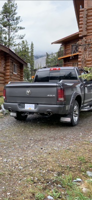

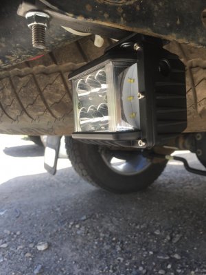

I put two 4” side shooters under my truck and wired them to my reverse wire in the trailer plug. I used a 2 3/4” muffler clamp to mount them to my receiver hitch. This way they’re tucked up out of the way and more adjustable than a flush mount that you have to cut holes in your bumper for. Plus, if you trade in your truck like I did, you can take your lights off and reuse them on the new truck.6F42932C-F82D-4DD2-81BD-4917597D715F.png7835C337-1173-4D16-8C1A-E17238629249.jpeg35ED7B32-F07F-4111-BB0C-6A98D337BF70.jpeg

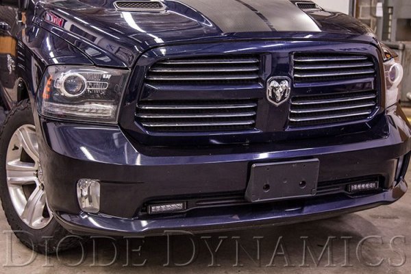

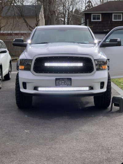

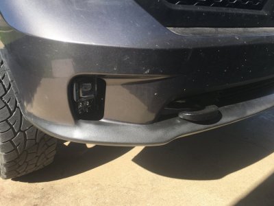

Rigid SRQ pros in the tow hook block off plates. 30” black our curved single row from rough country under the chrome bumper. I use a 40amp relay hooked to a 2 channel Remote so I can turn them on an off with no wiring into the truck.

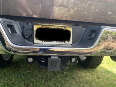

Rear I’m running superLEDs mini pods with home made brackets that mount to the hitch and I’m also running VLEDS rear backup license plate setup. the cleanest is the license plate light and the VLEDS one is super bright. The pods do a great job too at 1k lumens each and they have a 120* beam pattern. I can’t bring myself to cutting into the bumpers. So all my stuff is easy swapped out.

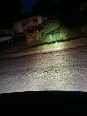

I don’t have any pics of the license plate reverse light. If I was to do it again that would prob be all that is needed and upgrading the stock reverse lights for a clean look. You can see the wide beam pattern of just the pods in the reverse camera shot.

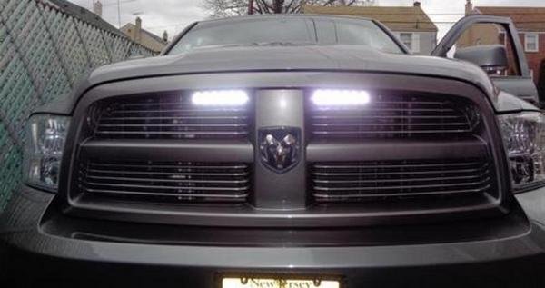

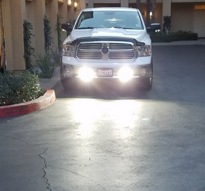

Pics of my last truck, waiting on the time to install on my new one,( still working).
Here are pics for you.
6" double row pods behind honeycomb grill, 40 watt flush mt in tow hook covers, led lows and fogs

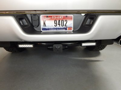

I like the flush mount rear lights, but didn't feel like cutting then into my bumper. I had done that on my 95 Dodge. I went with more of a "oval" style LED, and used "roll bar" light clamps, attaching them to the trailer hitch mount.

How did you Mount the pods on the hitch bracket?

90 degree brackets I bent out of 3/16” steel plate. Drilled and tapped for mounting through the hitch and the pods mount to the brackets via drilled holes I made 3 for each so I could adjust the depth.

Here’s a better shot with the pods and the license plate Vled backup light.
