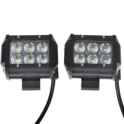

Did the same thing you're wanting to do for reverse except I used these instead. Just tap into the reverse wire or the constant 12V (If using a switch) on the back of the trailer harness and use any ground and you're good to go with no warnings.

Shouldn't throw a code for reverse lights. I replaced my halogen reverse bulbs with LED and don't have an issue. Sounds like the OP is adding LED in addition to the halogen, so the truck should detect sufficient load anyways.

Like this mod a lot.....Nice!

4c20058b9b747f2779e8f426b1760870.jpg I have those same lights. I tapped into the 7 pin reverse and it turns my parking sensors off sometimes. But other than that, they are great
