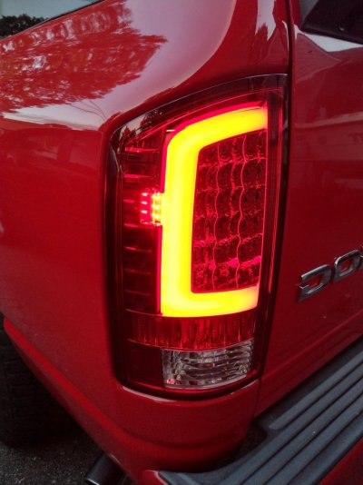

Better off just getting a whole compatible replacement, like these:
These were on my 2003 and were plug and play. Got rid of that incessant 'lamp out' ding once and for all. Available if you are interested.
