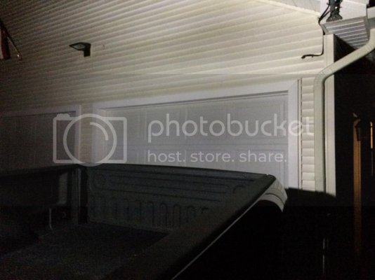

I decided to throw the LED 921's into the 3rd brake light area as the new cargo light, HUGE IMPROVEMENT
even with the flash on
