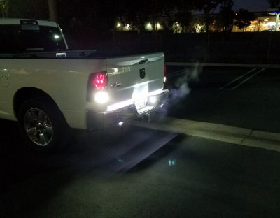

Same here - light out on start-up but doesn't bother me.
I installed Phillips Bright White 6000K LED Back-up Light Bulbs (921/T16) (H139649) - # 12789LPB2
